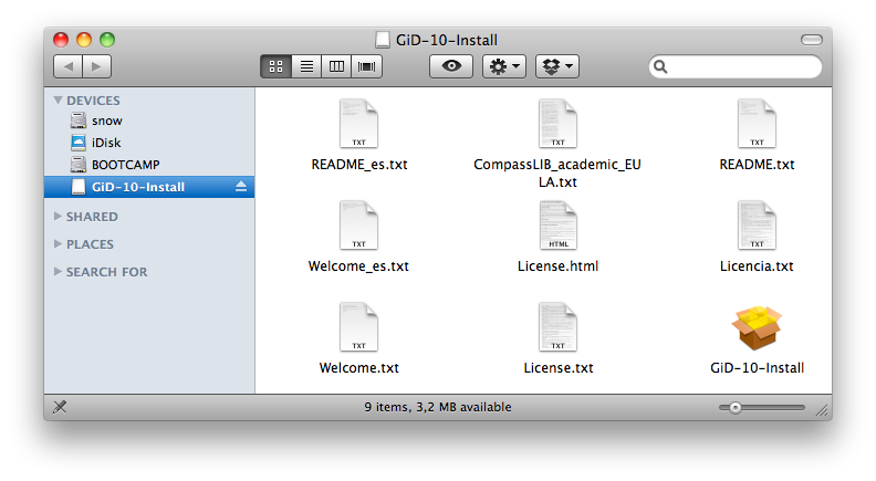

5. Double click on this volume to open its content in a new Finder window.

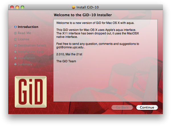

6. Execute GiD-xxxxxx-Install to open the installation program.
7. The installation program will create a link to GiD in your Application folder.
